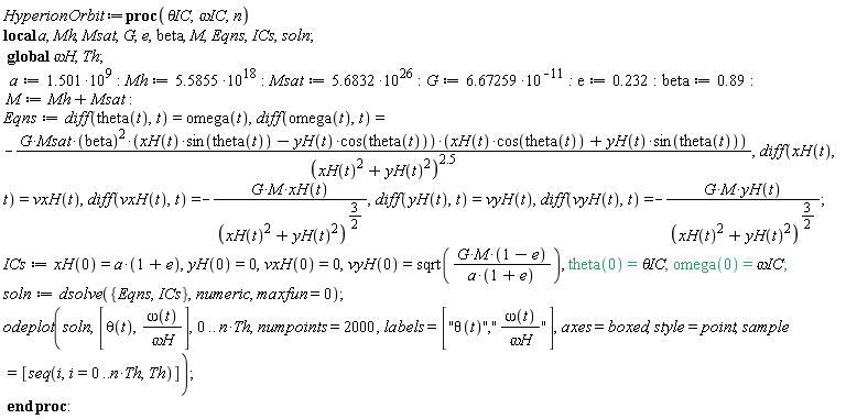

I've been trying to collect points at certain intervals in my plot, however, the sample option doesn't seem to be working. Can anyone lend me a hand? Any help is greatly appreciated! Thank you in advance!

HyperionOrbit := proc (`θIC`, `ωIC`, n) local a, Mh, Msat, G, e, beta, M, Eqns, ICs, soln; global `ωH`, Th; a := 1.501*10^9; Mh := 5.5855*10^18; Msat := 5.6832*10^26; G := 6.67259/10^11; e := .232; beta := .89; M := Mh+Msat; Eqns := diff(theta(t), t) = omega(t), diff(omega(t), t) = -G*Msat*beta^2*(xH(t)*sin(theta(t))-yH(t)*cos(theta(t)))*(xH(t)*cos(theta(t))+yH(t)*sin(theta(t)))/(xH(t)^2+yH(t)^2)^2.5, diff(xH(t), t) = vxH(t), diff(vxH(t), t) = -G*M*xH(t)/(xH(t)^2+yH(t)^2)^(3/2), diff(yH(t), t) = vyH(t), diff(vyH(t), t) = -G*M*yH(t)/(xH(t)^2+yH(t)^2)^(3/2); ICs := xH(0) = a*(1+e), yH(0) = 0, vxH(0) = 0, vyH(0) = sqrt(G*M*(1-e)/(a*(1+e))), theta(0) = `θIC`, omega(0) = `ωIC`; soln := dsolve({Eqns, ICs}, numeric, maxfun = 0); plots:-odeplot(soln, [theta(t), omega(t)/`ωH`], 0 .. n*Th, numpoints = 2000, labels = ["θ(t)","ω(t)/ωH"], axes = boxed, style = point, sample = [seq(i, i = 0 .. n*Th, Th)]) end proc:
HyperionOrbit(.5, 1.8*`ωH`, 10)
Error, (in plot/options2d) unexpected option: sample = [0, 1876321.326, 3752642.652, 5628963.978, 7505285.304, 9381606.630, 11257927.96, 13134249.28, 15010570.61, 16886891.93, 18763213.26]
