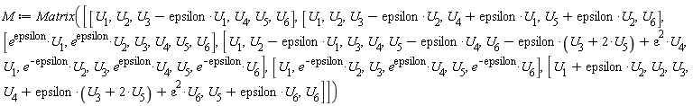

M := Matrix([[U[1], U[2], -epsilon*U[1]+U[3], U[4], U[5], U[6]], [U[1], U[2], -epsilon*U[2]+U[3], epsilon*U[1]+U[4], epsilon*U[2]+U[5], U[6]], [e^epsilon*U[1], e^epsilon*U[2], U[3], U[4], U[5], U[6]], [U[1], -epsilon*U[1]+U[2], U[3], U[4], -epsilon*U[4]+U[5], U[6]-epsilon*(U[3]+2*U[5])+epsilon^2*U[4], U[1], e^(-epsilon)*U[2], U[3], e^epsilon*U[4], U[5], e^(-epsilon)*U[6]], [U[1], e^(-epsilon)*U[2], U[3], e^epsilon*U[4], U[5], e^(-epsilon)*U[6]], [epsilon*U[2]+U[1], U[2], U[3], U[4]+epsilon*(U[3]+2*U[5])+epsilon^2*U[6], epsilon*U[6]+U[5], U[6]]])

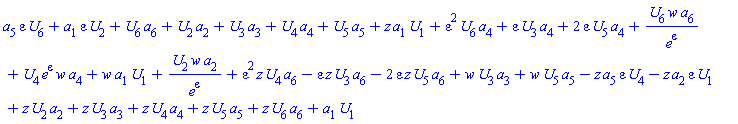

expand(algsubs(T[6]*U[6] = M[6, 6], expand(algsubs(T[6]*U[5] = M[6, 5], expand(algsubs(T[6]*U[4] = M[6, 4], expand(algsubs(T[6]*U[3] = M[6, 3], expand(algsubs(T[6]*U[2] = M[6, 2], expand(algsubs(T[6]*U[1] = M[6, 1], expand(algsubs(T[5]*U[6] = M[5, 6], expand(algsubs(T[5]*U[5] = M[5, 5], expand(algsubs(T[5]*U[4] = M[5, 4], expand(algsubs(T[5]*U[3] = M[5, 3], expand(algsubs(T[5]*U[2] = M[5, 2], expand(algsubs(T[5]*U[1] = M[5, 1], expand(algsubs(T[4]*U[6] = M[4, 6], expand(algsubs(T[4]*U[5] = M[4, 5], expand(algsubs(T[4]*U[4] = M[4, 4], expand(algsubs(T[4]*U[3] = M[4, 3], expand(algsubs(T[4]*U[2] = M[4, 2], expand(algsubs(T[4]*U[1] = M[4, 1], expand(algsubs(T[3]*U[6] = M[3, 6], expand(algsubs(T[3]*U[5] = M[3, 5], expand(algsubs(T[3]*U[4] = M[3, 4], expand(algsubs(T[3]*U[3] = M[3, 3], expand(algsubs(T[3]*U[2] = M[3, 2], expand(algsubs(T[3]*U[1] = M[3, 1], expand(algsubs(T[2]*U[6] = M[2, 6], expand(algsubs(T[2]*U[5] = M[2, 5], expand(algsubs(T[2]*U[4] = M[2, 4], expand(algsubs(T[2]*U[3] = M[2, 3], expand(algsubs(T[2]*U[3] = M[2, 3], expand(algsubs(T[2]*U[2] = M[2, 2], expand(algsubs(T[2]*U[1] = M[2, 1], expand(algsubs(T[1]*U[6] = M[1, 6], expand(algsubs(T[1]*U[5] = M[1, 5], expand(algsubs(T[1]*U[4] = M[1, 4], expand(algsubs(T[1]*U[3] = M[1, 3], expand(algsubs(T[1]*U[2] = M[1, 2], expand(algsubs(T[1]*U[1] = M[1, 1], w*T[5]*U[1]*a[1]+w*T[5]*U[2]*a[2]+w*T[5]*U[3]*a[3]+w*T[5]*U[4]*a[4]+w*T[5]*U[5]*a[5]+w*T[5]*U[6]*a[6]+z*T[4]*U[1]*a[1]+z*T[4]*U[2]*a[2]+z*T[4]*U[3]*a[3]+z*T[4]*U[4]*a[4]+z*T[4]*U[5]*a[5]+z*T[4]*U[6]*a[6]+T[6]*U[1]*a[1]+T[6]*U[2]*a[2]+T[6]*U[3]*a[3]+T[6]*U[4]*a[4]+T[6]*U[5]*a[5]+T[6]*U[6]*a[6]))))))))))))))))))))))))))))))))))))))))))))))))))))))))))))))))))))))))))
a[5]*epsilon*U[6]+a[1]*epsilon*U[2]+U[6]*a[6]+U[2]*a[2]+U[3]*a[3]+U[4]*a[4]+U[5]*a[5]+z*a[1]*U[1]+epsilon^2*U[6]*a[4]+epsilon*U[3]*a[4]+2*epsilon*U[5]*a[4]+U[6]*w*a[6]/e^epsilon+U[4]*e^epsilon*w*a[4]+w*a[1]*U[1]+U[2]*w*a[2]/e^epsilon+epsilon^2*z*U[4]*a[6]-epsilon*z*U[3]*a[6]-2*epsilon*z*U[5]*a[6]+w*U[3]*a[3]+w*U[5]*a[5]-z*a[5]*epsilon*U[4]-z*a[2]*epsilon*U[1]+z*U[2]*a[2]+z*U[3]*a[3]+z*U[4]*a[4]+z*U[5]*a[5]+z*U[6]*a[6]+a[1]*U[1]
But this procedure is complex, I want to use "subs" only. I know it complexity of terms in (3) might me creating problem.

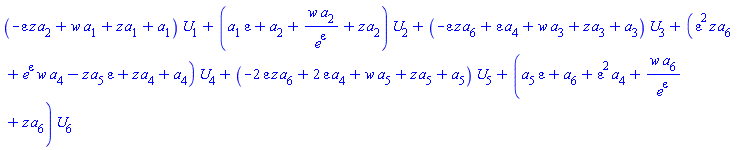

collect(a[5]*epsilon*U[6]+a[1]*epsilon*U[2]+U[6]*a[6]+U[2]*a[2]+U[3]*a[3]+U[4]*a[4]+U[5]*a[5]+z*a[1]*U[1]+epsilon^2*U[6]*a[4]+epsilon*U[3]*a[4]+2*epsilon*U[5]*a[4]+U[6]*w*a[6]/e^epsilon+U[4]*e^epsilon*w*a[4]+w*a[1]*U[1]+U[2]*w*a[2]/e^epsilon+epsilon^2*z*U[4]*a[6]-epsilon*z*U[3]*a[6]-2*epsilon*z*U[5]*a[6]+w*U[3]*a[3]+w*U[5]*a[5]-z*a[5]*epsilon*U[4]-z*a[2]*epsilon*U[1]+z*U[2]*a[2]+z*U[3]*a[3]+z*U[4]*a[4]+z*U[5]*a[5]+z*U[6]*a[6]+a[1]*U[1], [U[1], U[2], U[3], U[4], U[5], U[6]])
(-epsilon*z*a[2]+w*a[1]+z*a[1]+a[1])*U[1]+(a[1]*epsilon+a[2]+w*a[2]/e^epsilon+z*a[2])*U[2]+(-epsilon*z*a[6]+epsilon*a[4]+w*a[3]+z*a[3]+a[3])*U[3]+(epsilon^2*z*a[6]+e^epsilon*w*a[4]-z*a[5]*epsilon+z*a[4]+a[4])*U[4]+(-2*epsilon*z*a[6]+2*epsilon*a[4]+w*a[5]+z*a[5]+a[5])*U[5]+(a[5]*epsilon+a[6]+epsilon^2*a[4]+w*a[6]/e^epsilon+z*a[6])*U[6]
