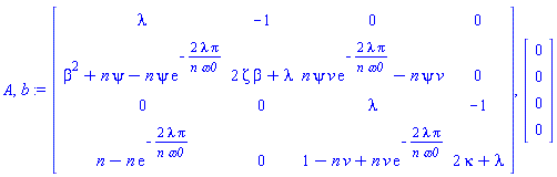

A, b := GenerateMatrix([seq(eqn[k], k = 1 .. 4)], [x[1], x[2], phi[1], phi[2]])
A, b := Matrix(4, 4, {(1, 1) = lambda, (1, 2) = -1, (1, 3) = 0, (1, 4) = 0, (2, 1) = beta^2+n*psi-n*psi*exp(-2*lambda*Pi/(n*omega0)), (2, 2) = 2*Zeta*beta+lambda, (2, 3) = n*psi*v*exp(-2*lambda*Pi/(n*omega0))-n*psi*v, (2, 4) = 0, (3, 1) = 0, (3, 2) = 0, (3, 3) = lambda, (3, 4) = -1, (4, 1) = n-n*exp(-2*lambda*Pi/(n*omega0)), (4, 2) = 0, (4, 3) = -n*v+1+n*v*exp(-2*lambda*Pi/(n*omega0)), (4, 4) = 2*kappa+lambda}), Vector(4, {(1) = 0, (2) = 0, (3) = 0, (4) = 0})

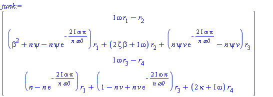

junk := MatrixVectorMultiply(subs(lambda = I*omega, A), right_vector)
junk := Matrix(4, 1, {(1, 1) = I*omega*r[1]-r[2], (2, 1) = (beta^2+n*psi-n*psi*exp(-(2*I)*omega*Pi/(n*omega0)))*r[1]+(2*Zeta*beta+I*omega)*r[2]+(n*psi*v*exp(-(2*I)*omega*Pi/(n*omega0))-n*psi*v)*r[3], (3, 1) = I*omega*r[3]-r[4], (4, 1) = (n-n*exp(-(2*I)*omega*Pi/(n*omega0)))*r[1]+(-n*v+1+n*v*exp(-(2*I)*omega*Pi/(n*omega0)))*r[3]+(2*kappa+I*omega)*r[4]})

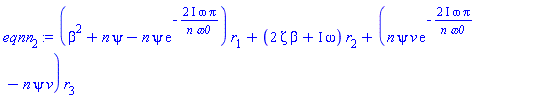

for k to 4 do eqnn[k] := junk(k) end do
I*omega*r[1]-r[2]
(beta^2+n*psi-n*psi*exp(-(2*I)*omega*Pi/(n*omega0)))*r[1]+(2*zeta*beta+I*omega)*r[2]+(n*psi*v*exp(-(2*I)*omega*Pi/(n*omega0))-n*psi*v)*r[3]
