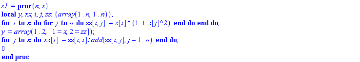

I would like to return local variable y (line 4 in showstat) in the attached dummy procedure (s1) without manually adding any comment inside the procedure s1. This procedure is a simple one and easy to copy paste/or change. When we have a long procedure, it is difficult to do so. I will always know the name of the local variable I want (say, y) and/or line number in showstat
PS, I want to get y:=array(1..,2[(1)=x,2=zz])

s1 := proc (n, x) local y, xx, i, j, zz::(array(1 .. n, 1 .. n)); for i to n do for j to n do zz[i, j] := x[i]*(1+x[j]^2) end do end do; y := array(1 .. 2, [1 = x, 2 = zz]); for j to n do xx[i] := zz[i, i]/add(zz[i, j], j = 1 .. n) end do; 0 end proc
