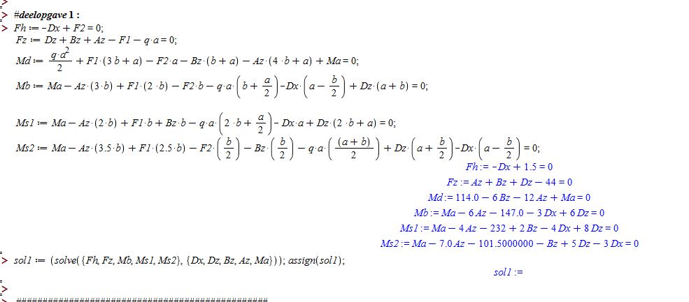

I am trying to solve several equations for some mechanics problem.
I made the following lines with variables: Az, Bz, Dz, Dx, Ma.
The equations are showed in the image below. I can use either Md equation or Mb to solve the problem, but using both is not allowed. I tried to solve the equations with the solve function, but cant find any answer though there should be?
