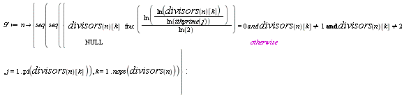

with(numtheory):
`&Fscr;` := proc (n) options operator, arrow; {seq(seq(piecewise(frac(ln(ln(divisors(n)[k])/ln(ithprime(j)))/ln(2)) = 0 and divisors(n)[k] <> 1 and divisors(n)[k] <> 2, divisors(n)[k], NULL), j = 1 .. pi(divisors(n)[k])), k = 1 .. nops(divisors(n)))} end proc
`&Fscr;`(200000)
{4, 5, 16, 25, 625}
Download 21052018.mw
So basically, because it is very hard for me to break habits once i have formed them, my question is, is it going to be beneficial for me to switch to this persons method of enumeration, or am i ok just to continue my way?
