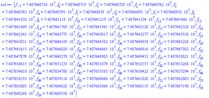

I am trying to write a finite difference Method solution for an ODE and its giving me problem solving the algebraic simplifications generated. Please, any one with useful informations. Below is the attached file
FDM1.mw

sol := fsolve([op(eqs)])
{f[-1] = 74076407.16, f[0] = 74076407.19, f[1] = 74076407.29, f[2] = 74076407.42, f[3] = 74076407.63, f[4] = 74076407.95, f[5] = 74076408.39, f[6] = 74076408.95, f[7] = 74076409.58, f[8] = 74076410.32, f[9] = 74076411.18, f[10] = 74076412.19, f[11] = 74076413.34, f[12] = 74076414.66, f[13] = 74076416.09, f[14] = 74076417.69, f[15] = 74076419.41, f[16] = 74076421.28, f[17] = 74076423.28, f[18] = 74076425.45, f[19] = 74076427.75, f[20] = 74076430.17, f[21] = 74076432.77, f[22] = 74076435.56, f[23] = 74076438.51, f[24] = 74076441.69, f[25] = 74076445.02, f[26] = 74076448.54, f[27] = 74076452.24, f[28] = 74076456.15, f[29] = 74076460.29, f[30] = 74076464.65, f[31] = 74076469.16, f[32] = 74076473.82, f[33] = 74076478.70, f[34] = 74076483.79, f[35] = 74076489.05, f[36] = 74076494.52, f[37] = 74076500.21, f[38] = 74076506.15, f[39] = 74076512.33, f[40] = 74076518.79, f[41] = 74076525.57, f[42] = 74076532.68, f[43] = 74076540.10, f[44] = 74076547.80, f[45] = 74076555.85, f[46] = 74076564.23, f[47] = 74076572.94, f[48] = 74076581.93, f[49] = 74076591.18, f[50] = 74076600.60, f[51] = 74076610.20, f[52] = 74076620.03, f[53] = 74076630.05, f[54] = 74076640.28, f[55] = 74076650.64, f[56] = 74076661.19, f[57] = 74076671.90, f[58] = 74076682.68, f[59] = 74076693.50}
