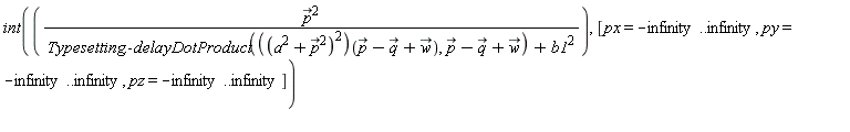

What is it that's wrong with the following input in Maple?
Note that all variables are real. The sample worksheet is attached.

int(`#mover(mi("p"),mo("→"))`^2/(Typesetting:-delayDotProduct(((a^2+`#mover(mi("p"),mo("→"))`^2)^2)(`#mover(mi("p"),mo("→"))`-`#mover(mi("q"),mo("→"))`+`#mover(mi("w"),mo("→"))`), `#mover(mi("p"),mo("→"))`-`#mover(mi("q"),mo("→"))`+`#mover(mi("w"),mo("→"))`)+b1^2), [px = -infinity .. infinity, py = -infinity .. infinity, pz = -infinity .. infinity])
