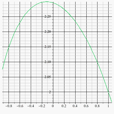

xp1 := 1; yp1 := 2; lprp1 := -coeff(ltg1, y)*x+coeff(ltg1, x)*y+K1; for i to nops(sol1) do s := eval(sol1[i], x = r); print("s  ", s); K1 := solve(eval(lprp1, [x = xp1, y = yp1]), K1); print("K1  ", K1); sol2 := solve([ltg1, lprp1], [x, y]); Pedal || i := [rhs(sol2[1, 1]), rhs(sol2[1, 2])]; p9 || i := plot([op(Pedal || i), r = -20 .. 20], colour = "MediumSeaGreen"); unassign('K1', 'sol2') end do
"K1  ", -4*(-r^2-12*r-9-2*(8*r^3+36*r^2+54*r+27)^(1/2))^(3/2)-4*r^2*(-r^2-12*r-9-2*(8*r^3+36*r^2+54*r+27)^(1/2))^(1/2)+16*(8*r^3+36*r^2+54*r+27)^(1/2)*r-48*r*(-r^2-12*r-9-2*(8*r^3+36*r^2+54*r+27)^(1/2))^(1/2)+192*r^2+96*(8*r^3+36*r^2+54*r+27)^(1/2)-36*(-r^2-12*r-9-2*(8*r^3+36*r^2+54*r+27)^(1/2))^(1/2)+576*r+432
seq(simplify(Pedal || i), i = 1 .. nops(sol1))
[((((2*r+3)^3)^(1/2)+6*r+9)*(-r^2-12*r-9+2*((2*r+3)^3)^(1/2))^(1/2)-2*(r-3)*(r^2+(5/2)*r-((2*r+3)^3)^(1/2)+3/2))/(4*r^2-6*r-18), ((-2*r^2-3*r-((2*r+3)^3)^(1/2))*(-r^2-12*r-9+2*((2*r+3)^3)^(1/2))^(1/2)+6*(r-3)*(r-(1/6)*((2*r+3)^3)^(1/2)+3/2))/(4*r^2-6*r-18)], [((-((2*r+3)^3)^(1/2)-6*r-9)*(-r^2-12*r-9+2*((2*r+3)^3)^(1/2))^(1/2)-2*(r-3)*(r^2+(5/2)*r-((2*r+3)^3)^(1/2)+3/2))/(4*r^2-6*r-18), ((2*r^2+((2*r+3)^3)^(1/2)+3*r)*(-r^2-12*r-9+2*((2*r+3)^3)^(1/2))^(1/2)+6*(r-3)*(r-(1/6)*((2*r+3)^3)^(1/2)+3/2))/(4*r^2-6*r-18)], [((6*r-((2*r+3)^3)^(1/2)+9)*(-r^2-2*((2*r+3)^3)^(1/2)-12*r-9)^(1/2)-2*(r-3)*(r^2+(5/2)*r+((2*r+3)^3)^(1/2)+3/2))/(4*r^2-6*r-18), ((-2*r^2+((2*r+3)^3)^(1/2)-3*r)*(-r^2-2*((2*r+3)^3)^(1/2)-12*r-9)^(1/2)+6*(r-3)*(r+(1/6)*((2*r+3)^3)^(1/2)+3/2))/(4*r^2-6*r-18)], [((((2*r+3)^3)^(1/2)-6*r-9)*(-r^2-2*((2*r+3)^3)^(1/2)-12*r-9)^(1/2)-2*(r-3)*(r^2+(5/2)*r+((2*r+3)^3)^(1/2)+3/2))/(4*r^2-6*r-18), ((2*r^2-((2*r+3)^3)^(1/2)+3*r)*(-r^2-2*((2*r+3)^3)^(1/2)-12*r-9)^(1/2)+6*(r-3)*(r+(1/6)*((2*r+3)^3)^(1/2)+3/2))/(4*r^2-6*r-18)]
plots:-display(p21, seq(p9 || i, i = 1 .. nops(sol1)), size = [600, 600], scaling = constrained, caption = " Curve and it's Pedal curve")
This I can't get to work. All 4 sections of the pedal curve are the same and should not be.
