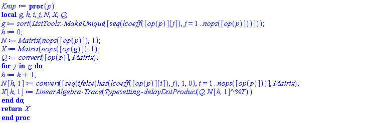

Question: split a polynomial based on leading integer coefficients
I could not find a command that splits a polynomial in parts based on leading integer coefficients, so I wrote a procedure. It works well, but I still wonder if there is no simpler way of doing this?
My aim is to investigate whether there is some way of factoring this and other polynomials.

Knip := proc (p) local g, h, i, j, N, X, Q; g := sort(ListTools:-MakeUnique([seq(lcoeff([op(p)][j]), j = 1 .. nops([op(p)]))])); h := 0; N := Matrix(nops([op(p)]), 1); X := Matrix(nops([op(g)]), 1); Q := convert([op(p)], Matrix); for j in g do h := h+1; N[h, 1] := convert([seq(ifelse(has(lcoeff([op(p)][i]), j), 1, 0), i = 1 .. nops([op(p)]))], Matrix); X[h, 1] := LinearAlgebra:-Trace(Q.N[h, 1]^%T) end do; return X end proc
proc (p) local g, h, i, j, N, X, Q; g := sort(ListTools:-MakeUnique([seq(lcoeff([op(p)][j]), j = 1 .. nops([op(p)]))])); h := 0; N := Matrix(nops([op(p)]), 1); X := Matrix(nops([op(g)]), 1); Q := convert([op(p)], Matrix); for j in g do h := h+1; N[h, 1] := convert([seq(ifelse(has(lcoeff([op(p)][i]), j), 1, 0), i = 1 .. nops([op(p)]))], Matrix); X[h, 1] := LinearAlgebra:-Trace(Typesetting:-delayDotProduct(Q, N[h, 1]^%T)) end do; return X end proc

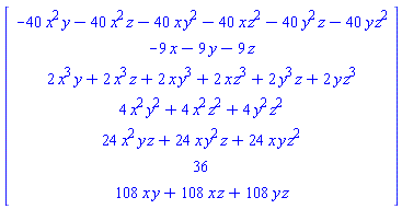

Knip(p)
Matrix(%id = 18446747088530918086)
(11)
simplify(p-Trace(Matrix(1, 7, 1).Knip(p)))
