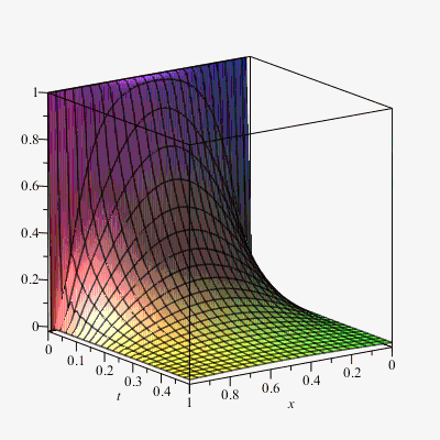

plot3d(my_u(x,t), x=0..1, t=0..0.5);

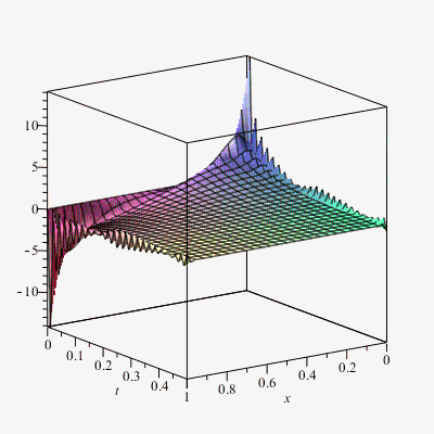

plot3d(my_v(x,t), x=0..1, t=0..0.5);

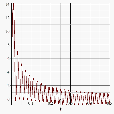

The oscillations are numerical artifacts.  Can they be avoided?
plot(my_v(0,t), t=0..0.5);
A side comment: By eliminating vbetween the two PDEs we see that u
satisfies the standard heat equation, thus vis the flux.  The expression
v(0, t) expresses the heat flux at the boundary, and that's what I am after.
