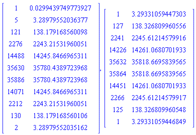

# carl love's procedure with slight modifications t
SampleCheck := proc(X, f, N::posint)
uses St= Statistics;
  local S, M, O, E:
  S:= f(N):
  M:= numelems(S):
  O:= <St:-TallyInto(S, <[$(floor@min-1..ceil@max)(S)]>)>:
  E:= St:-Probability~(X <~ (rhs@lhs)~(O), 'numeric') * M:
  <rhs~(O)[2..] | E[2..] - E[..-2]>
interface(rtablesize=20):
SampleCheck(Statistics:-RandomVariable(Normal(0,1)), 'BoxMuller_1', 10^5),
SampleCheck(Statistics:-RandomVariable(Normal(0,1)), 'BoxMuller_2', 10^5);
Matrix(11, 2, {(1, 1) = 1, (1, 2) = HFloat(0.029943974977392658), (2, 1) = 5, (2, 2) = HFloat(3.28979552036377), (3, 1) = 121, (3, 2) = HFloat(138.1791685600983), (4, 1) = 2276, (4, 2) = HFloat(2243.2153196005097), (5, 1) = 14488, (5, 2) = HFloat(14245.846696531142), (6, 1) = 35630, (6, 2) = HFloat(35780.43897239682), (7, 1) = 35886, (7, 2) = HFloat(35780.43897239682), (8, 1) = 14071, (8, 2) = HFloat(14245.846696531138), (9, 1) = 2212, (9, 2) = HFloat(2243.2153196005092), (10, 1) = 130, (10, 2) = HFloat(138.1791685601056), (11, 1) = 2, (11, 2) = HFloat(3.2897955203516176)}), Matrix(10, 2, {(1, 1) = 1, (1, 2) = HFloat(3.293310594473029), (2, 1) = 127, (2, 2) = HFloat(138.32680996055558), (3, 1) = 2241, (3, 2) = HFloat(2245.6121457991635), (4, 1) = 14226, (4, 2) = HFloat(14261.068070193269), (5, 1) = 35632, (5, 2) = HFloat(35818.66958395649), (6, 1) = 35864, (6, 2) = HFloat(35818.66958395649), (7, 1) = 14451, (7, 2) = HFloat(14261.068070193272), (8, 1) = 2266, (8, 2) = HFloat(2245.6121457991685), (9, 1) = 125, (9, 2) = HFloat(138.32680996054842), (10, 1) = 1, (10, 2) = HFloat(3.293310594468494)})
