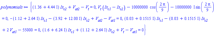

polynomials := {f1n2, f3n4, f5n6, f7n8, f9n10};
{(1.36+4.44*I)*Ix[c2]+V[at2]-V[t] = 0, V[t]*(Ix[c1]-Ix[c2])-10000000*cos((2/9)*Pi)-(10000000*I)*sin((2/9)*Pi) = 0, (-1.12-2.64*I)*Ix[c1]+(-3.92-12.00*I)*Ix[c2]+V[at2]-V[at1] = 0, (0.3e-1+.1515*I)*Ix[c1]+(-0.3e-1-.1515*I)*Ix[c2]+2*V[at1]-55000 = 0, (1.6+6.24*I)*Ix[c1]+(1.12+2.64*I)*Ix[c2]+V[t]-V[at1] = 0}

Then, when 'f9n10 := V[t] * (Ix[c1] - Ix[c2]) + TrainLoad = 0;' becomes 'f9n10 := V[t] * conjugate(Ix[c1] - Ix[c2]) + TrainLoad = 0;',
the command ('fsolve()') refused to produce a solution.
Would you tell me how to make the 'fsolve()' command work with the 'conjugate()' operator?
