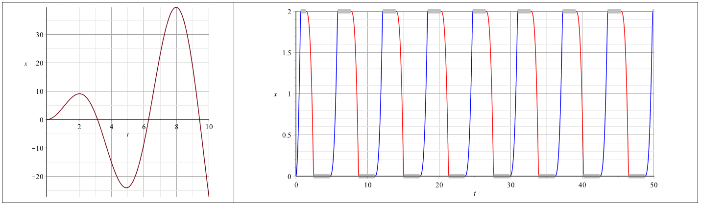

Here are two images to help you understand what happens:
  1. the first one represents the "unbounded" solution of the system above
  2. the second is the "bounded" solution
To obtain the right picture I construct the solution piecewise (the method, based on events and the use of discrete variables, is described in the attached file).
For some reasons I would like to build the global solution "in one shot" and no longer have to assemble it from elementary pieces (the blue, red and gray chunks on the right figure).
