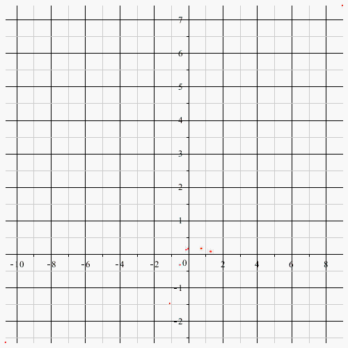

redp := plots:-pointplot(points, colour = red, symbolsize = 4, symbol = solidcircle)
plots:-pointplot(points2, colour = red, symbolsize = 4, symbol = solidcircle)
Error, invalid input: `if` expects 3 arguments, but received 2
