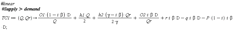

TC1 := proc (Q, Qr) options operator, arrow; O1*(-beta*i+1)*D/Q+(1/2)*h1*Q+(1/2)*h2*(-beta*i+gamma)*Qr/gamma+O2*i*beta*D/Qr+r*i*beta*D-q*i*beta*D-P*(1-i)*i*beta*D end proc

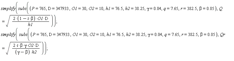

simplify(subs(P = 765, D = 347933, O1 = 30, O2 = 10, h1 = 76.5, h2 = 38.25, gamma = 0.4e-1, q = 7.65, r = 382.5, beta = 0.5e-1, Q = sqrt((2*(-beta*i+1))*O1*D/h1))); simplify(subs(P = 765, D = 347933, O1 = 30, O2 = 10, h1 = 76.5, h2 = 38.25, gamma = 0.4e-1, q = 7.65, r = 382.5, beta = 0.5e-1, Qr = sqrt(2*i*beta*gamma*O2*D/((gamma-beta)*h2))))
Q = 3230.787830*(-0.1307189542e-2*i+0.2614379084e-1)^(1/2)
Qr = 190.7489196*(-i)^(1/2)

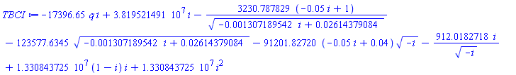

TBCI := TBC-TCo+TI
-17396.65*q*i+38195214.91*i-3230.787829*(-0.5e-1*i+1)/(-0.1307189542e-2*i+0.2614379084e-1)^(1/2)-123577.6345*(-0.1307189542e-2*i+0.2614379084e-1)^(1/2)-91201.82720*(-0.5e-1*i+0.4e-1)*(-i)^(1/2)-912.0182718*i/(-i)^(1/2)+13308437.25*(1-i)*i+13308437.25*i^2
(30)
NLPSolve(TBCI, {eq1, eq2, eq3, eq4}, assume = nonnegative)
Error, (in Optimization:-NLPSolve) constraints must be specified as a set or list of equalities and inequalities
