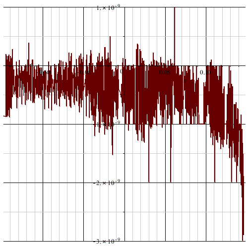

simplify(convert(1+x*hypergeom([1, 4/3, 5/3], [2, 5/2], (27/4)*x)-hypergeom([1/3, 2/3], [3/2], (27/4)*x), elementary), symbolic)
(1/3)*(3*x^(1/2)+3*x^(3/2)*hypergeom([1, 4/3, 5/3], [2, 5/2], (27/4)*x)-2*3^(1/2)*sin((1/3)*arcsin((3/2)*3^(1/2)*x^(1/2))))/x^(1/2)
plot((1/3)*(3*x^(1/2)+3*x^(3/2)*hypergeom([1, 4/3, 5/3], [2, 5/2], (27/4)*x)-2*3^(1/2)*sin((1/3)*arcsin((3/2)*3^(1/2)*x^(1/2))))/x^(1/2), x = -4/27 .. 4/27)
verify(0, (1/3)*(3*x^(1/2)+3*x^(3/2)*hypergeom([1, 4/3, 5/3], [2, 5/2], (27/4)*x)-2*3^(1/2)*sin((1/3)*arcsin((3/2)*3^(1/2)*x^(1/2))))/x^(1/2), 'equal')
FAIL
