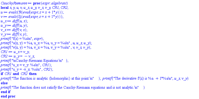

Also ran the procedure through the AI for so-called code improvement and now it shows what the code stands for
# Improved and corrected version of the CauchyRiemann procedure :ASKED AI
CauchyRiemann := proc(expr::algebraic)
    local x, y, u, v, u_x, u_y, v_x, v_y, CR1, CR2;
    # Assign real and imaginary parts of the function
    u := evalc(Re(eval(expr, z = x + I*y)));
    v := evalc(Im(eval(expr, z = x + I*y)));
    # Calculate partial derivatives
    u_x := diff(u, x);
    u_y := diff(u, y);
    v_x := diff(v, x);
    v_y := diff(v, y);
    # Properly format and print function details
    printf("f(z) = %a\n", expr);
    printf("u(x, y) = %a, u_x = %a, u_y = %a\n", u, u_x, u_y);
    printf("v(x, y) = %a, v_x = %a, v_y = %a\n", v, v_x, v_y);
    # Evaluate and print Cauchy-Riemann equations
    CR1 := u_x = v_y;
    CR2 := u_y = -v_x;
    printf("\nCauchy-Riemann Equations:\n");
    printf("u_x = v_y: %a\n", CR1);
    printf("u_y = -v_x: %a\n", CR2);
    # Check both equations
    if CR1 and CR2 then
        printf("The function is analytic (holomorphic) at this point.\n");
        printf("The derivative f'(z) is %a + I*%a\n", u_x, v_y);
    else
        printf("The function does not satisfy the Cauchy-Riemann equations and is not analytic.\n");
    end if;
end proc;
# Test the procedure with a specific function
f := z -> 1/(z + 2);
CauchyRiemann(f(z));
"maple.ini in users"
proc (expr::algebraic) local x, y, u, v, u_x, u_y, v_x, v_y, CR1, CR2; u := evalc(Re(eval(expr, z = x+I*y))); v := evalc(Im(eval(expr, z = x+I*y))); u_x := diff(u, x); u_y := diff(u, y); v_x := diff(v, x); v_y := diff(v, y); printf("f(z) = %a
", expr); printf("u(x, y) = %a, u_x = %a, u_y = %a
", u, u_x, u_y); printf("v(x, y) = %a, v_x = %a, v_y = %a
", v, v_x, v_y); CR1 := u_x = v_y; CR2 := u_y = -v_x; printf("
"); printf("u_x = v_y: %a
", CR1); printf("u_y = -v_x: %a
", CR2); if CR1 and CR2 then printf("The function is analytic (holomorphic) at this point.
"); printf("The derivative f'(z) is %a + I*%a
", u_x, v_y) else printf("The function does not satisfy the Cauchy-Riemann equations and is not analytic.
") end if end proc
proc (z) options operator, arrow; 1/(z+2) end proc
f(z) = 1/(z+2)
u(x, y) = (x+2)/(y^2+(x+2)^2), u_x = 1/(y^2+(x+2)^2)-(x+2)/(y^2+(x+2)^2)^2*(2*x+4), u_y = -2*(x+2)/(y^2+(x+2)^2)^2*y
v(x, y) = -y/(y^2+(x+2)^2), v_x = y/(y^2+(x+2)^2)^2*(2*x+4), v_y = -1/(y^2+(x+2)^2)+2*y^2/(y^2+(x+2)^2)^2
u_x = v_y: 1/(y^2+(x+2)^2)-(x+2)/(y^2+(x+2)^2)^2*(2*x+4) = -1/(y^2+(x+2)^2)+2*y^2/(y^2+(x+2)^2)^2
u_y = -v_x: -2*(x+2)/(y^2+(x+2)^2)^2*y = -y/(y^2+(x+2)^2)^2*(2*x+4)
