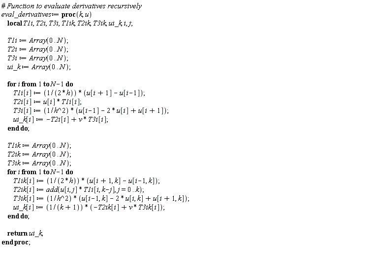

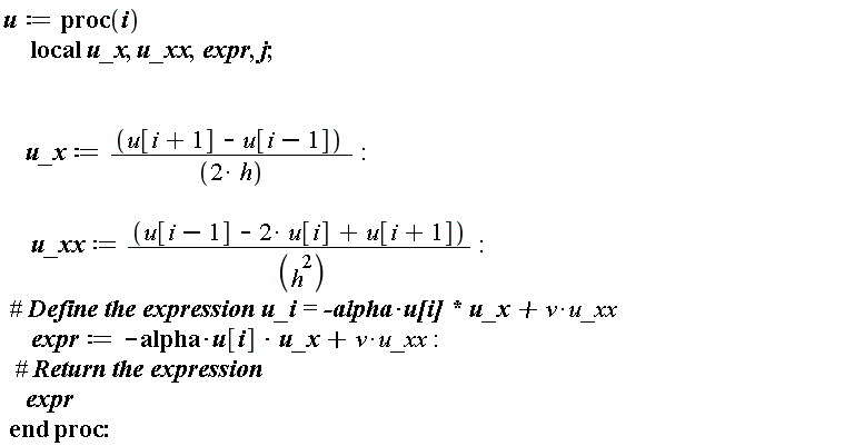

Question: How do i resolve my code which encountering error in a loop for repeated differentiation?
i am trying to make code for automatic differentiation method. kindly help me out with that. i have asked chatgpt too. i am going to attach my file alongwith chatgpt code kindly help meautomatic_differentiation.mw

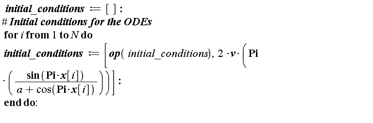

initial_conditions := []; for i to N do initial_conditions := [op(initial_conditions), 2*v*Pi*sin(Pi*x[i])/(a+cos(Pi*x[i]))] end do
u := proc (i) local u_x, u_xx, expr, j; u_x := (1/2)*(u[i+1]-u[i-1])/h; u_xx := (u[i-1]-2*u[i]+u[i+1])/h^2; expr := -alpha*u[i]*u_x+v*u_xx; expr end proc

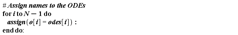

for i to N-1 do assign(o[i] = odes[i]) end do

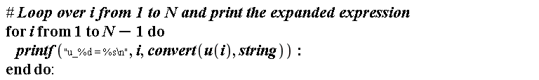

for i to N-1 do printf("u_%d = %s\n", i, convert(u(i), string)) end do

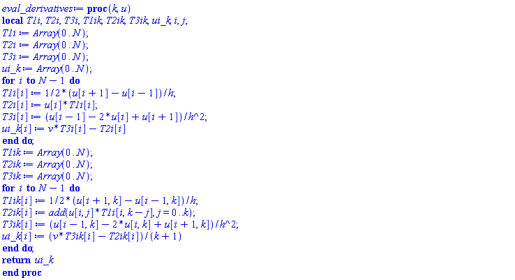

eval_derivatives := proc (k, u) local T1i, T2i, T3i, T1ik, T2ik, T3ik, ui_k, i, j; T1i := Array(0 .. N); T2i := Array(0 .. N); T3i := Array(0 .. N); ui_k := Array(0 .. N); for i to N-1 do T1i[i] := (1/2)*(u[i+1]-u[i-1])/h; T2i[i] := u[i]*T1i[i]; T3i[i] := (u[i-1]-2*u[i]+u[i+1])/h^2; ui_k[i] := v*T3i[i]-T2i[i] end do; T1ik := Array(0 .. N); T2ik := Array(0 .. N); T3ik := Array(0 .. N); for i to N-1 do T1ik[i] := (1/2)*(u[i+1, k]-u[i-1, k])/h; T2ik[i] := add(u[i, j]*T1i[i, k-j], j = 0 .. k); T3ik[i] := (u[i-1, k]-2*u[i, k]+u[i+1, k])/h^2; ui_k[i] := (v*T3ik[i]-T2ik[i])/(k+1) end do; return ui_k end proc

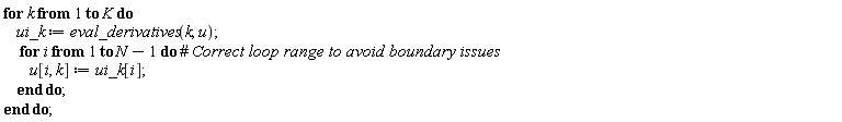

for k to K do ui_k := eval_derivatives(k, u); for i to N-1 do u[i, k] := ui_k[i] end do end do
Error, (in eval_derivatives) Array index out of range

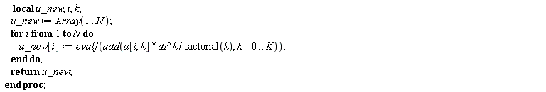

"     local u_new, i, k;      u_new := Array(1..N);      for i from 1 to N do          u_new[i] := evalf(add(u[i, k] * dt^k / factorial(k), k = 0 .. K));      end do;      return u_new;  end proc;"
Error, unable to parse

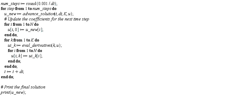

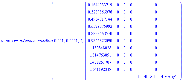

num_steps := round(0.1e-2/dt); for step to num_steps do u_new := advance_solution(t, dt, K, u); for i to N do u[i, 0] := u_new[i] end do; for k to K do ui_k := eval_derivatives(k, u); for i to N do u[i, k] := ui_k[i] end do end do; t := t+dt end do; print(u_new)
num_steps := 10
advance_solution(0.1e-2, 0.1e-3, 4, Array(%id = 36893489585014251020))
