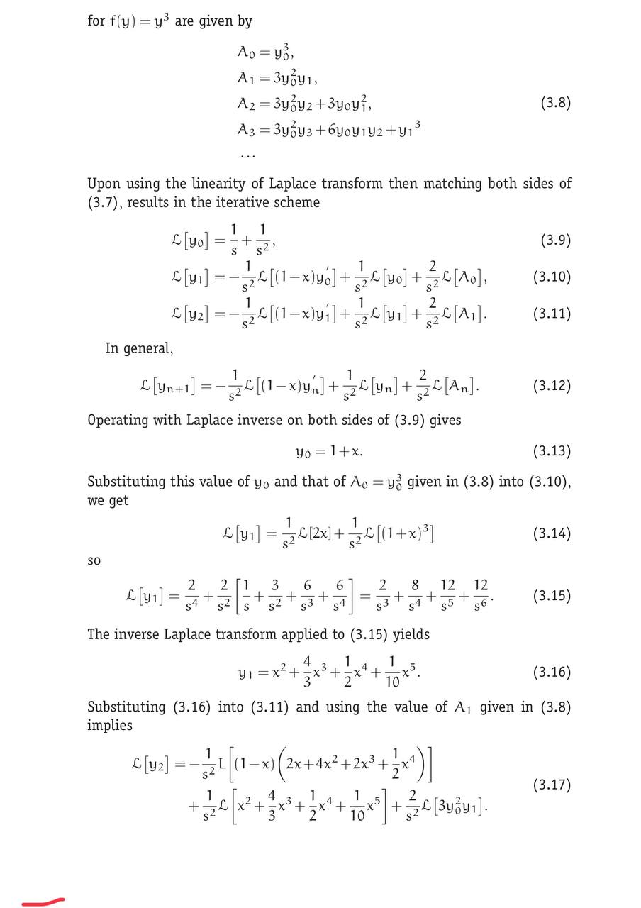

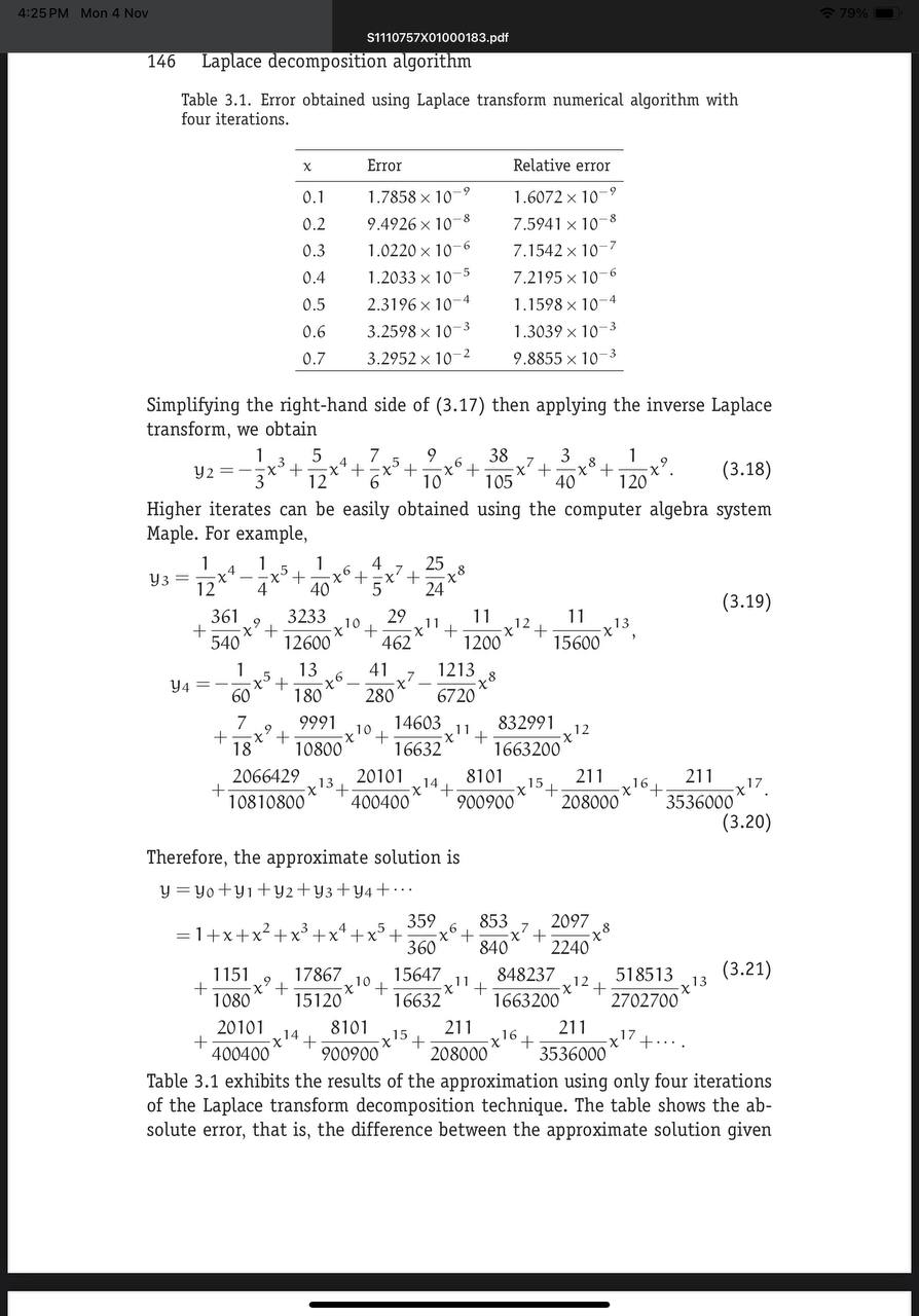

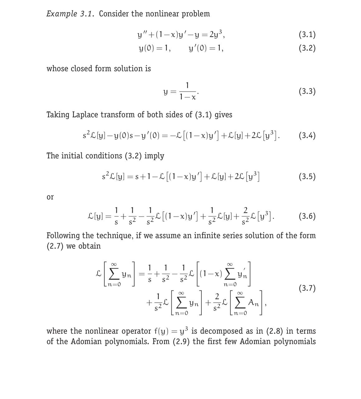

Question: How solve this Special ODE ?
This question is related to the Question How collect series solution of PDE?
I upload picture of solution and i try to solve but i fail i don't know how maple can do that just take laplace of one sidehow posible ?

example 1 i could't solve but example to i did
