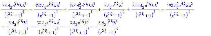

Question: How this ODE will be zero-the result in not acceptable why?
this equation will be solve by changing variable but when  i found the function and substitute the ODE is not zero where  is mistake?

odetest(E, ode)
32*A[2]*exp(8*xi)*lambda*k^3/(exp(2*xi)+1)^5-352*A[2]*exp(6*xi)*lambda*k^3/(exp(2*xi)+1)^5+192*A[2]^2*exp(6*xi)*lambda*k^2/(exp(2*xi)+1)^5+8*A[2]*exp(8*xi)*lambda^2/(exp(2*xi)+1)^5+352*A[2]*exp(4*xi)*lambda*k^3/(exp(2*xi)+1)^5-192*A[2]^2*exp(4*xi)*lambda*k^2/(exp(2*xi)+1)^5+8*A[2]*exp(6*xi)*lambda^2/(exp(2*xi)+1)^5-32*A[2]*exp(2*xi)*lambda*k^3/(exp(2*xi)+1)^5-8*A[2]*exp(4*xi)*lambda^2/(exp(2*xi)+1)^5-8*A[2]*exp(2*xi)*lambda^2/(exp(2*xi)+1)^5
