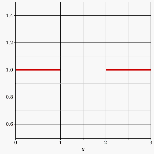

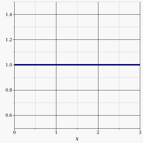

I wish to plot two line segments over the intervals [0,1] and [2,3].  Maple 2024 draws a single line segment over [0,3].  Oddly enough, if I specify a color option, then it produces the expected result!

plots:-display(
        plot(1, x=0..1),
         plot(1, x=2..3), thickness=5);
plots:-display(
        plot(1, x=0..1),
         plot(1, x=2..3),thickness=5, color=red);
