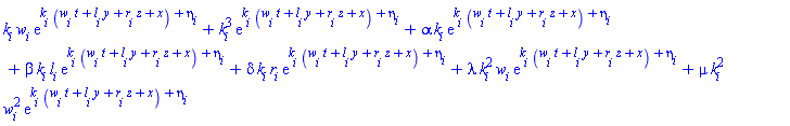

#third example which is so different and really i don't know how the author reach this point? which is diff(arctan(f),x)?
with(PDEtools)
with(LinearAlgebra)
with(SolveTools)
_local(gamma)
undeclare(prime)
(26)
declare(u(x, y, z, t))
u(x, y, z, t)*`will now be displayed as`*u
(27)
declare(f(x, y, z, t))
f(x, y, z, t)*`will now be displayed as`*f
(28)
pde := diff(u(x, y, z, t), t)+6*u(x, y, z, t)^2*(diff(u(x, y, z, t), x))+diff(u(x, y, z, t), `$`(x, 3))+alpha*(diff(u(x, y, z, t), x))+beta*(diff(u(x, y, z, t), y))+delta*(diff(u(x, y, z, t), z))+lambda*(diff(u(x, y, z, t), x, t))+mu*(diff(u(x, y, z, t), `$`(t, 2)))
diff(u(x, y, z, t), t)+6*u(x, y, z, t)^2*(diff(u(x, y, z, t), x))+diff(diff(diff(u(x, y, z, t), x), x), x)+alpha*(diff(u(x, y, z, t), x))+beta*(diff(u(x, y, z, t), y))+delta*(diff(u(x, y, z, t), z))+lambda*(diff(diff(u(x, y, z, t), t), x))+mu*(diff(diff(u(x, y, z, t), t), t))
(29)
pde_linear, pde_nonlinear := selectremove(proc (term) options operator, arrow; not has((eval(term, u(x, y, z, t) = a*u(x, y, z, t)))/a, a) end proc, expand(pde))
diff(u(x, y, z, t), t)+diff(diff(diff(u(x, y, z, t), x), x), x)+alpha*(diff(u(x, y, z, t), x))+beta*(diff(u(x, y, z, t), y))+delta*(diff(u(x, y, z, t), z))+lambda*(diff(diff(u(x, y, z, t), t), x))+mu*(diff(diff(u(x, y, z, t), t), t)), 6*u(x, y, z, t)^2*(diff(u(x, y, z, t), x))
(30)
thetai := k[i]*(t*w[i]+y*l[i]+z*r[i]+x)+eta[i]; eval(pde_linear, u(x, y, z, t) = exp(thetai)); eq15 := isolate(%, w[i])
k[i]*w[i]*exp(k[i]*(t*w[i]+y*l[i]+z*r[i]+x)+eta[i])+k[i]^3*exp(k[i]*(t*w[i]+y*l[i]+z*r[i]+x)+eta[i])+alpha*k[i]*exp(k[i]*(t*w[i]+y*l[i]+z*r[i]+x)+eta[i])+beta*k[i]*l[i]*exp(k[i]*(t*w[i]+y*l[i]+z*r[i]+x)+eta[i])+delta*k[i]*r[i]*exp(k[i]*(t*w[i]+y*l[i]+z*r[i]+x)+eta[i])+lambda*k[i]^2*w[i]*exp(k[i]*(t*w[i]+y*l[i]+z*r[i]+x)+eta[i])+mu*k[i]^2*w[i]^2*exp(k[i]*(t*w[i]+y*l[i]+z*r[i]+x)+eta[i])
w[i] = (1/2)*(-lambda*k[i]-1+(-4*beta*mu*k[i]*l[i]-4*delta*mu*k[i]*r[i]+lambda^2*k[i]^2-4*mu*k[i]^3-4*alpha*mu*k[i]+2*lambda*k[i]+1)^(1/2))/(mu*k[i])
(31)
eqf := f(x, y, z, t) = 1+eval(exp(thetai), eq15)
f(x, y, z, t) = 1+exp(k[i]*((1/2)*(-lambda*k[i]-1+(-4*beta*mu*k[i]*l[i]-4*delta*mu*k[i]*r[i]+lambda^2*k[i]^2-4*mu*k[i]^3-4*alpha*mu*k[i]+2*lambda*k[i]+1)^(1/2))*t/(mu*k[i])+l[i]*y+r[i]*z+x)+eta[i])
(32)
eq17 := u(x, y, z, t) = R*(diff(ln(f(x, y, z, t)), x))
u(x, y, z, t) = R*((diff(diff(f(x, y, z, t), y), y))/f(x, y, z, t)-(diff(f(x, y, z, t), y))^2/f(x, y, z, t)^2)
(33)
eval(eq17, eqf); simplify(eval(pde, %)); sort([solve(%, R)]); eq17 := eval(eq17, R = simplify(%[2]))
