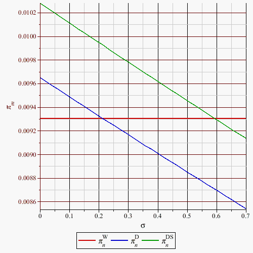

Question: How to mark intersection points
Suppose I am plotting a 2D plot and want to highlight the point where two lines intersect. I would like to display this intersection point inside the plot in black font, mark it with an arrow or some visual highlight, and clearly label it. How can I do this?
Additionally, instead of using different colours (blue, green, red) for the lines, I want to distinguish them using different line styles such as solid, dotted, and long-dashed lines. How can I make these changes?

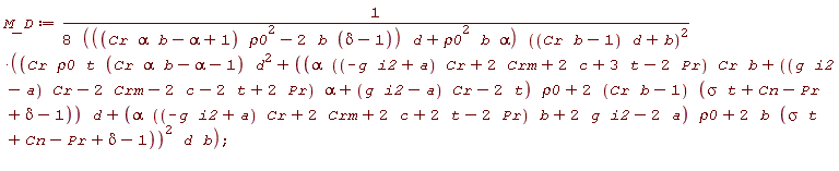

M_D := (Cr*rho0*t*(Cr*alpha*b-alpha-1)*d^2+((alpha*((-g*i2+a)*Cr+2*Crm+2*c+3*t-2*Pr)*Cr*b+((g*i2-a)*Cr-2*Crm-2*c-2*t+2*Pr)*alpha+(g*i2-a)*Cr-2*t)*rho0+(2*(Cr*b-1))*(sigma*t+Cn-Pr+delta-1))*d+(alpha*((-g*i2+a)*Cr+2*Crm+2*c+2*t-2*Pr)*b+2*g*i2-2*a)*rho0+2*b*(sigma*t+Cn-Pr+delta-1))^2*d*b/((8*(((Cr*alpha*b-alpha+1)*rho0^2-2*b*(delta-1))*d+rho0^2*b*alpha))*((Cr*b-1)*d+b)^2)
(Cr*rho0*t*(Cr*alpha*b-alpha-1)*d^2+((alpha*((-g*i2+a)*Cr+2*Crm+2*c+3*t-2*Pr)*Cr*b+((g*i2-a)*Cr-2*Crm-2*c-2*t+2*Pr)*alpha+(g*i2-a)*Cr-2*t)*rho0+(2*Cr*b-2)*(sigma*t+Cn-Pr+delta-1))*d+(alpha*((-g*i2+a)*Cr+2*Crm+2*c+2*t-2*Pr)*b+2*g*i2-2*a)*rho0+2*b*(sigma*t+Cn-Pr+delta-1))^2*d*b/((8*((Cr*alpha*b-alpha+1)*rho0^2-2*b*(delta-1))*d+8*rho0^2*b*alpha)*((Cr*b-1)*d+b)^2)

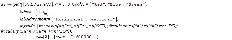

A1 := plot([P11, P21, P31], sigma = 0 .. .7, color = ["Red", "Blue", "Green"], labels = [sigma, `π__m`], labeldirections = ["horizontal", "vertical"], legend = [`#msubsup(mi("π"),mi("n"),mn("W"));`, `#msubsup(mi("π"),mi("n"),mn("D"));`, `#msubsup(mi("π"),mi("n"),mn("DS"));`], axis[2] = [color = "#600000"])
display(A1, pointplot([[X, Y]], symbol = circle, symbolsize = 25, color = blue))
Error, (in plots:-pointplot) points cannot be converted to floating-point values
