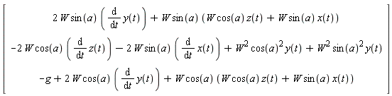

F[resultant]:=F[gravity]+F[Coriolis]+F[centrifugal];
Vector(3, {(1) = 2*W*sin(a)*(diff(y(t), t))+W*sin(a)*(W*cos(a)*z(t)+W*sin(a)*x(t)), (2) = -2*W*cos(a)*(diff(z(t), t))-2*W*sin(a)*(diff(x(t), t))+W^2*cos(a)^2*y(t)+W^2*sin(a)^2*y(t), (3) = -g+2*W*cos(a)*(diff(y(t), t))+W*cos(a)*(W*cos(a)*z(t)+W*sin(a)*x(t))})

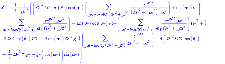

X := -(1/4)*(Omega^4*V0*sin(theta)*cos(alpha)*(sum(exp(_alpha1*t)/((Omega^2+_alpha1^2)*_alpha1), _alpha1 = RootOf(Omega^2+_Z^2)))+cos(alpha)*g*(sum(exp(_alpha1*t)*_alpha1^2/(Omega^2+_alpha1^2), _alpha1 = RootOf(Omega^2+_Z^2)))-sin(theta)*cos(alpha)*V0*(sum(exp(_alpha1*t)*_alpha1/(Omega^2+_alpha1^2), _alpha1 = RootOf(Omega^2+_Z^2)))*Omega^2+(-2*Omega^3*cos(theta)*V0+3*cos(alpha)*Omega^2*g)*(sum(exp(_alpha1*t)/(Omega^2+_alpha1^2), _alpha1 = RootOf(Omega^2+_Z^2)))+4*(Omega^2*t*V0*sin(theta)-(1/2)*Omega^2*t^2*g-g)*cos(alpha))*sin(alpha)/Omega^2

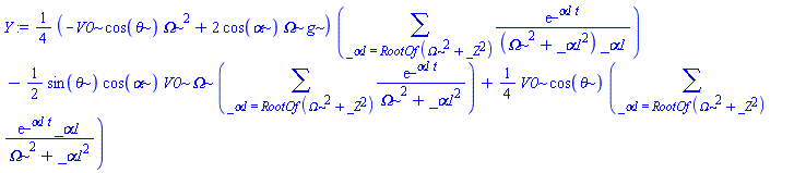

Y := (1/4)*(-V0*cos(theta)*Omega^2+2*cos(alpha)*Omega*g)*(sum(exp(_alpha1*t)/((Omega^2+_alpha1^2)*_alpha1), _alpha1 = RootOf(Omega^2+_Z^2)))-(1/2)*sin(theta)*cos(alpha)*V0*Omega*(sum(exp(_alpha1*t)/(Omega^2+_alpha1^2), _alpha1 = RootOf(Omega^2+_Z^2)))+(1/4)*V0*cos(theta)*(sum(exp(_alpha1*t)*_alpha1/(Omega^2+_alpha1^2), _alpha1 = RootOf(Omega^2+_Z^2)))

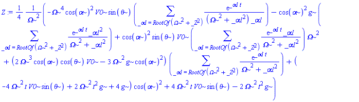

Z := (1/4)*(-Omega^4*cos(alpha)^2*V0*sin(theta)*(sum(exp(_alpha1*t)/((Omega^2+_alpha1^2)*_alpha1), _alpha1 = RootOf(Omega^2+_Z^2)))-cos(alpha)^2*g*(sum(exp(_alpha1*t)*_alpha1^2/(Omega^2+_alpha1^2), _alpha1 = RootOf(Omega^2+_Z^2)))+cos(alpha)^2*sin(theta)*V0*(sum(exp(_alpha1*t)*_alpha1/(Omega^2+_alpha1^2), _alpha1 = RootOf(Omega^2+_Z^2)))*Omega^2+(2*Omega^3*cos(alpha)*cos(theta)*V0-3*Omega^2*g*cos(alpha)^2)*(sum(exp(_alpha1*t)/(Omega^2+_alpha1^2), _alpha1 = RootOf(Omega^2+_Z^2)))+(-4*Omega^2*t*V0*sin(theta)+2*Omega^2*t^2*g+4*g)*cos(alpha)^2+4*Omega^2*t*V0*sin(theta)-2*Omega^2*t^2*g)/Omega^2
