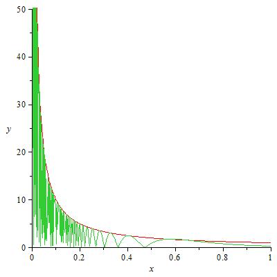

It's a little odd that these two answers came out the same. It's easy to see that q does change signs infinitely often in [0,1]. A nice visualization of this can be obtained with:
plot([1/x,abs(q)],x=0..1,y=0..50);

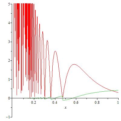

plot( [q, Q], x=0..1, view=[DEFAULT,-5..5] ):
plot( [abs(q), Q2], x=0..1, view=[DEFAULT,-1..5] );

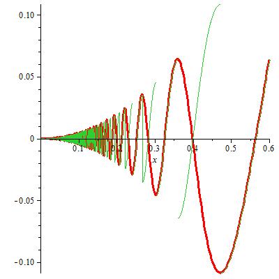

plot( [Q,Q2], x=0..0.6, thickness=[3,1], discont=true );
Clearly, the two improper integrals at the start of this post should not have the same values.

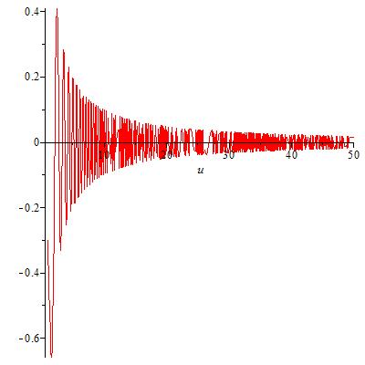

It's a little interesting that the absolute values have disappeared. (A plot quickly shows that this integrand is not always an increasing function.
q2 := GetIntegrand( Combine(I2) );
                                / 2\      / 2\  2
                            -sin\u / + cos\u / u
                                      3
                                     u
plot( q2, u=1..50 );
