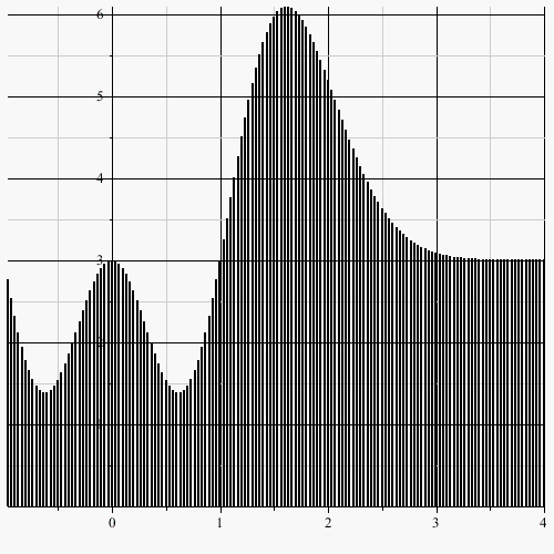

We test the optimize procedure with the following function
f:=x->3+10*(-x^2+x^4)*exp(-x^2);
proc (x) options operator, arrow; 3+10*(-x^2+x^4)*exp(-x^2) end proc
on the interval [-1, 4].
optimize(f,-1,4,150,pic);
`maximum y value is`, 6.088066652, `and occurs at these x values`, {1.633333333}
`minimum y value is`, 1.391538737, `and occurs at these x values`, {-.6333333333, .6333333333}
pic;
