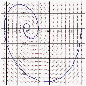

sys := {diff(x(t), t) = y(t), diff(y(t), t) = -x(t) - 1/2*y(t)}
{diff(x(t), t) = y(t), diff(y(t), t) = -x(t)-(1/2)*y(t)}
DEplot(sys, [x(t), y(t)], t = 0 .. 15, [[x(0) = 1, y(0) = 0]])
This is not working, seems to be simple ...

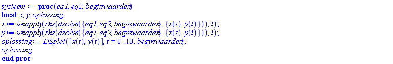

systeem := proc(eq1, eq2, beginwaarden)
  local x, y, oplossing;
  x := unapply(rhs(dsolve({eq1, eq2, beginwaarden}, {x(t), y(t)})), t);
  y := unapply(rhs(dsolve({eq1, eq2, beginwaarden}, {x(t), y(t)})), t);
  oplossing := DEplot([x(t), y(t)], t = 0 .. 10, beginwaarden);
  oplossing;
end proc;

"maple.ini in users"
proc (eq1, eq2, beginwaarden) local x, y, oplossing; x := unapply(rhs(dsolve({eq1, eq2, beginwaarden}, {x(t), y(t)})), t); y := unapply(rhs(dsolve({eq1, eq2, beginwaarden}, {x(t), y(t)})), t); oplossing := DEplot([x(t), y(t)], t = 0 .. 10, beginwaarden); oplossing end proc
Error, (in dsolve) invalid input: PDEtools/sdsolve expects its 1st argument, SYS, to be of type Or(set({`<>`, `=`, algebraic}),list({`<>`, `=`, algebraic}),`casesplit/ans`(list,list)), but received {diff(x(t),t) = y(t), diff(y(t),t) = -x(t), [x(0) = 1, y(0) = 0]}
Probably i do need to work with a debugger here?
