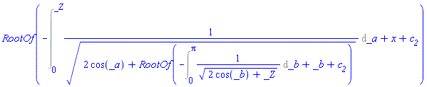

Is there an easier or shorter way to do the following? Any handy package command?
RootOf(-(Int(1/sqrt(2*cos(_a)+RootOf(-(Int(1/sqrt(2*cos(_a)+_Z), _a = 0 .. Pi))+_a+c__2)), _a = 0 .. _Z))+x+c__2)

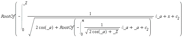

RootOf(-(Int(1/(2*cos(_a)+RootOf(-(Int(1/(2*cos(_a)+_Z)^(1/2), _a = 0 .. Pi))+_a+c__2))^(1/2), _a = 0 .. _Z))+x+c__2)

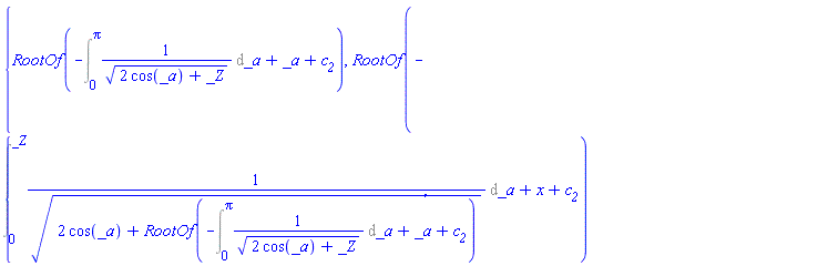

indets(RootOf(-(Int(1/(2*cos(_a)+RootOf(-(Int(1/(2*cos(_a)+_Z)^(1/2), _a = 0 .. Pi))+_a+c__2))^(1/2), _a = 0 .. _Z))+x+c__2), 'specfunc(anything, RootOf)')
{RootOf(-(Int(1/(2*cos(_a)+_Z)^(1/2), _a = 0 .. Pi))+_a+c__2), RootOf(-(Int(1/(2*cos(_a)+RootOf(-(Int(1/(2*cos(_a)+_Z)^(1/2), _a = 0 .. Pi))+_a+c__2))^(1/2), _a = 0 .. _Z))+x+c__2)}
subs(_a = _b, {RootOf(-(Int(1/(2*cos(_a)+_Z)^(1/2), _a = 0 .. Pi))+_a+c__2), RootOf(-(Int(1/(2*cos(_a)+RootOf(-(Int(1/(2*cos(_a)+_Z)^(1/2), _a = 0 .. Pi))+_a+c__2))^(1/2), _a = 0 .. _Z))+x+c__2)}[1])
RootOf(-(Int(1/(2*cos(_b)+_Z)^(1/2), _b = 0 .. Pi))+_b+c__2)
subs({RootOf(-(Int(1/(2*cos(_a)+_Z)^(1/2), _a = 0 .. Pi))+_a+c__2), RootOf(-(Int(1/(2*cos(_a)+RootOf(-(Int(1/(2*cos(_a)+_Z)^(1/2), _a = 0 .. Pi))+_a+c__2))^(1/2), _a = 0 .. _Z))+x+c__2)}[1] = RootOf(-(Int(1/(2*cos(_b)+_Z)^(1/2), _b = 0 .. Pi))+_b+c__2), RootOf(-(Int(1/(2*cos(_a)+RootOf(-(Int(1/(2*cos(_a)+_Z)^(1/2), _a = 0 .. Pi))+_a+c__2))^(1/2), _a = 0 .. _Z))+x+c__2))
RootOf(-(Int(1/(2*cos(_a)+RootOf(-(Int(1/(2*cos(_b)+_Z)^(1/2), _b = 0 .. Pi))+_b+c__2))^(1/2), _a = 0 .. _Z))+x+c__2)
