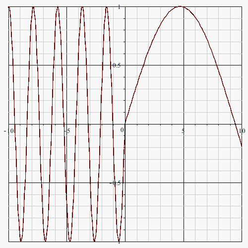

Question: Graphing a piecewise function
Should be that i was thinking on the use the arrow operator for a function definition and to use this for graphing this function
It becomes complicated.
the following piecewise-defined function was considered
exc set 4 task 1a
sin(3*x): # x <= 0 .. must be evaluated to true or false for branching to      #other second function
sin(x/3): # otherwise
h:=proc(x)
   if x<=0 then sin(3*x)
   else sin(x/3)
   fi;
maplemint(h);
h(1); #
sin(1/3)
h(1.0);
.3271946968
Strange that this function notation e.g h(1) can be used for a expression ?, while the idea was to use this only for a function defintion with a arrow operator  ( function as a procedure )
Seems to be possible to use the notation e.g : h(1) or h(1.0) if the input parameter is numeric for a expression.
The condition in the if statement must be(can only) evaluated numeric..that seems to be not possible with the arrow operator definition in the procedure.
h(x);
Error, (in h) cannot determine if this expression is true or false: x <= 0
plot('h(x)'); # delay of the evaluation of h(x)
plot(h);
