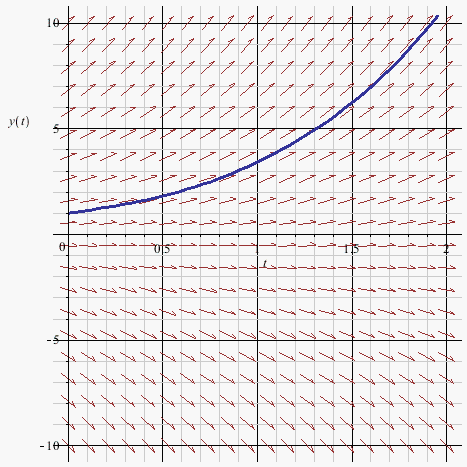

Question: Odegenerator plots
Found this old procedure code and revived it
Trying to include an Exploreplot as well
a0,a1,a2,b1,b2 are coeifficents in a ode to construct
How about odetype when constructing a ode is this correct in code?

    odeplot_cmd := DEtools[DEplot](eq, y(x), x = 0 .. 2, y = -10 .. 10, [[y(0) = 1]]);
    print(plots:-display(odeplot_cmd, size = [550, 550]));
            printf("The found function for row number %d is:\n", df);
            print(Fsol);

The found function for row number 25 is:
-(1/2)*cos(t)-(1/2)*sin(t)+c__1*exp(t)
